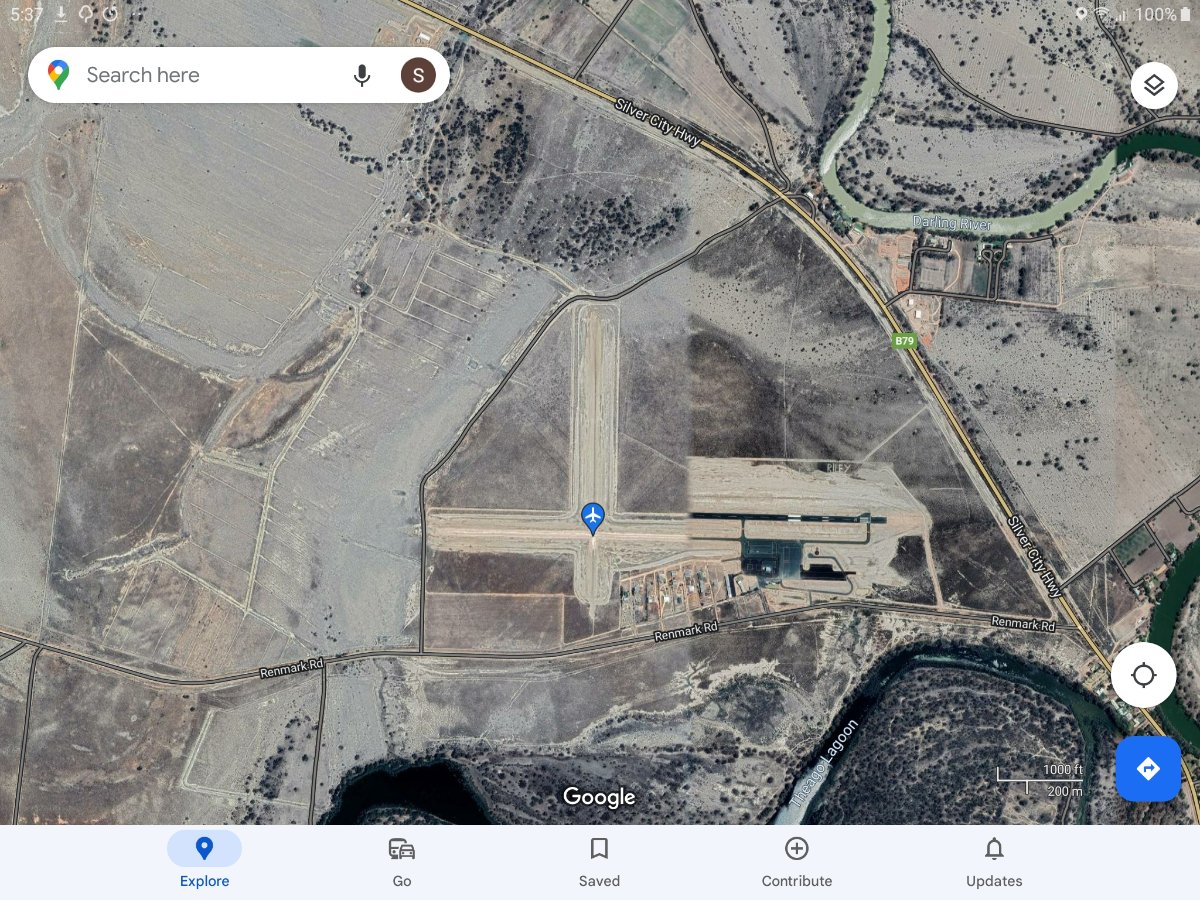

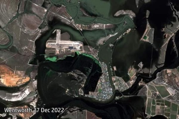

Thruster88 Posted January 3, 2023 Share Posted January 3, 2023 (edited) My 2 cents worth. Clear pics on Facebook show glassy water in all pics indicating light winds. There is a fire truck about 100m behind the aircraft, most likely on the end of runway 35, so takeoff to the north on the shorter runway, could be wrong but seems to fit the pics. Runway 26, 1400 meters, has no obstacles to clear. Always do a pre takeoff briefing to self. Both runways are sealed now. Edited January 3, 2023 by Thruster88 1 1 Link to comment Share on other sites More sharing options...
