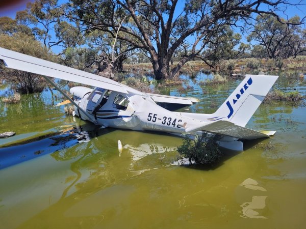

old man emu Posted January 3, 2023 Share Posted January 3, 2023 I don't think that it is fair to be dissing the Jabiru engine in 2023, based on the pre-2010 products. That engine was in development pre-2010. If Jabiru had not continued development to correct identified faults, the company would be like Humpty-Dumpty at the base of the wall. Do you think that the first Rolls Royce Merlin was perfect in every way? In a lecture to the de Havilland Aircraft Technical Department in November 1945, Mr A.C. Lovesey told the attendees that "It is well known that a completely new design of piston engine takes nearly five years from the date of its inception until it can start quantity production." And he was referring to design and development by a company that had (in 1935) been building engines successfully for thirty years. And the 1935 Merlin was a doddering grandfather to the later 51 different Marks of that design. And that development was kicked along by a savage war. http://www.wwiiaircraftperformance.org/merlin-lovesey.pdf It's probably wise not to place one's absolute faith in one of the early Jabiru engines, compared to a 2022-built one. However, if that early engine is still performing within specs, then I'd say the owner has scored a good'un. We go on and on about these engines suddenly stopping, but you must consider all the possible ways to stop an engine, from catastrophic component failure to an insect blocking a fuel line. 2 2 1 Link to comment Share on other sites More sharing options...
BrendAn Posted January 3, 2023 Share Posted January 3, 2023 i have been told they were taking off. if roscoes theory is correct and the jab was sluggish in the heat with a full load maybe they could not gain height quick enough and clipped the trees which caused the crash. just an idea but i thought you would cut the throttle and drop back onto the runway if it did not feel right. 3 1 Link to comment Share on other sites More sharing options...

old man emu Posted January 3, 2023 Share Posted January 3, 2023 Let's get back to the initial post. I ask: "Where did BirdDog get what he posted from?" To me it reads like a media release - therefore I am suspicious of "The 'Jabiru' ultralight lost power". That reeks of ignorant journalism. Now, let's inspect the aircraft. Am I wrong in suggesting that the flaps were extended to a degree? That the elevator position indicates a controlled flare? I'll concede that the position was caused by the twisting of the rear fuselage that could have shifted the control connections. Are they cables to the elevator and rudder? Wing position in relation to the cabin seems normal. The plane clipped trees That mark on the leading edge of the right wing looks more like a slap than a whack, and a single impact with something - tree, not "trees". I can't see a likely tree back along the approach path. Can a Jab pilot tell me what the yellow thing hanging out of the engine bay is? That cowl is held in place by the axle of a piano hinge. I can't see the hinge having been broken at impact. I surmise that the cowl was opened by the Evidence Eradication Team "to disconnect the battery to prevent a fire". The distortion to port of the lower engine cowl tells me that a force was applied from front starboard side to the rear port side. I surmise that it was as a result of the nose wheel hitting the ground under the water. That force, acting on the aircraft forward of the CofG would induce an anti-clockwise rotation to the airframe, resulting in the bending of the rear fuselage to starboard. The rotation could account for the separation of the left wing at the root. This final photo doesn't take us any further in the analysis, except to say that the pilot got selecting the best place to land correct. 1 Link to comment Share on other sites More sharing options...
RFguy Posted January 3, 2023 Share Posted January 3, 2023 (edited) Jab's are fine. Gen1,2,3 : do not fly with leakdowns < 65/80 or CHT > 160C or EGT > (770 - fuel flow percentage). (EGT values for air cooled heads) 40 deg C, 'sea level ' density altitude is 3000' ! .... and if there was a low overhead, add another 300 feet maybe.... so performance is down about 20% ! add to this higher chances of ULP (?) fuel vapourization (was fuel pump turned on in takeoff to pressurize the lines etc ) ?? etc etc so it probably has a climb rate of 400 hundred feet a minute two up.... at best then to all that- add a thermal SINK , for example...... (OME the thing hanging out is the oil catch can) Edited January 3, 2023 by RFguy 1 1 Link to comment Share on other sites More sharing options...
old man emu Posted January 3, 2023 Share Posted January 3, 2023 3 minutes ago, RFguy said: (OME the thing hanging out is the oil catch can) To get it to come loose would require a good whack in the direction of force I indicated, and a good deal of oil in it to give it the inertia to stay put while the firewall moved away from it.. Even if it did, how do you explain the unhinged cowl? 1 Link to comment Share on other sites More sharing options...

Roscoe Posted January 3, 2023 Share Posted January 3, 2023 7 hours ago, Flightrite said: At the end of the day it’s just another Jab engine failure, they are well known for that and there will be more (as long as they’re not mine😉) The guys lived to tell the story, that’s the main thing, the rest will just go into the stat books! What proof do you have that it was an engine FAILURE! The engine may have been operating normally but the ambient weather, weight, density height and Wind may gave degraded the performance and affected the climb profile. How about waiting for the investigation results before saying, just another Jab engine failure! 1 1 1 1 Link to comment Share on other sites More sharing options...

Methusala Posted January 3, 2023 Share Posted January 3, 2023 Sometimes, even fairly experienced pilots succumb to fixed ideas such as, "Ive taken off many times in this aircraft with no problems", and continue attempting to levitate even as the end of the strip is approaching fast. Having achieved faltering flight in ground effect next one wing hits a low branch which yaws the plane and further degrades the climb. The pilot and passenger are now hapless spectators to the ensuing ground contact. I subscribe to the high density altitude as the best possible explanation. This view has no connection to the real circumstance, just an armchair theory. Don 2 1 1 Link to comment Share on other sites More sharing options...
