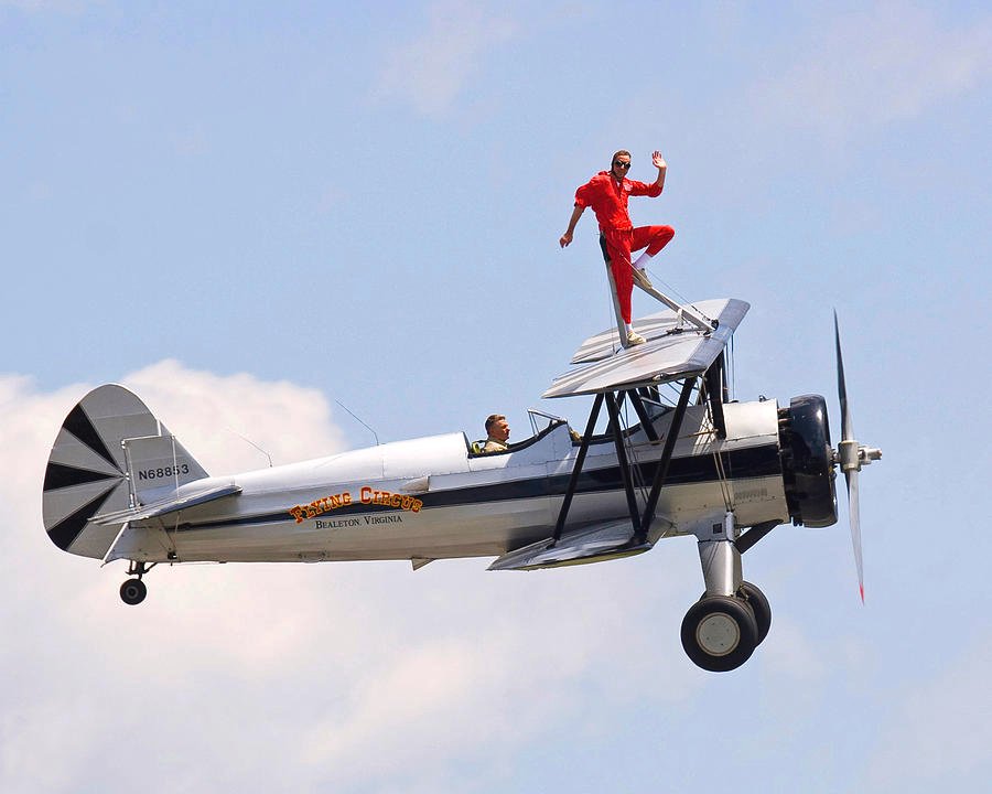

ARO said
(1B)  Subregulations (1) and (1A) do not apply to prevent a member of the crew having temporary access to:
                     (a)  any part of the aircraft for the purpose of executing repairs or adjustments to the aircraft or its equipment
because you wouldn't want to make a rule that would stop people climbing on the wing or undercarriage to make repairs or adjustments in flight!
Then this looks like it's legal, per Subsection (1B)
